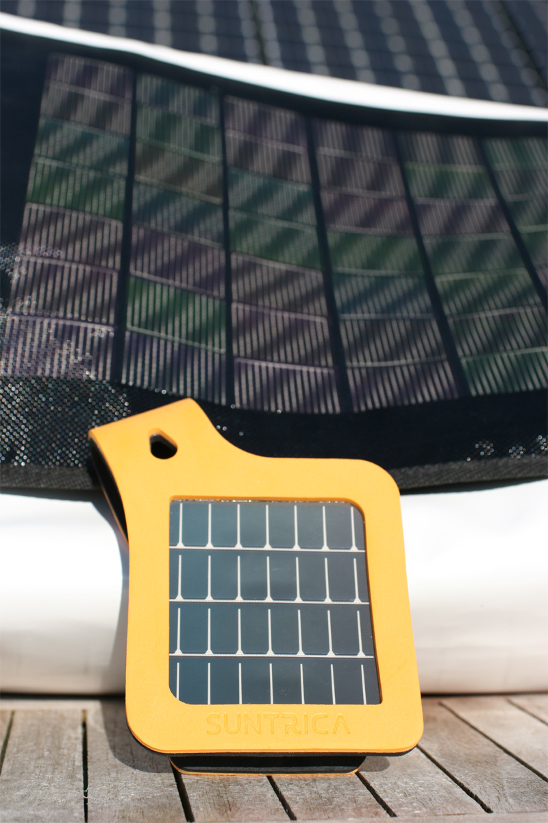

Solar power
Our test conditions in detail:
- Discharging SolarStrap
- 2 hours charging at orientation to the midday sun, cloudless sky, 20 ° C
- Discharging SolarStrap and measuring the watt hours: 0.41 Wh
- Surface of the solar panel: 48 cm2
- Assumed solar radiation with 0.1 watts per cm2
- System efficiency of 4.3 %
A very good value for such a compact system!

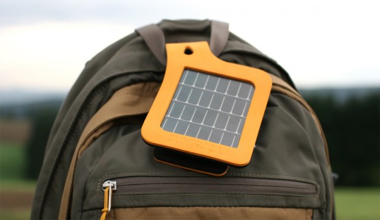

Attaching the SolarStrap to a backpack or strapping it more or less vertically to the body (as recommended by the manufacturer), is hardly loaded effectively. In an 8-hour day trip in perfect weather through forest and meadow (50/50) at the end of the day we could reach only 0.32 watt hours. As with all solar applications, the durable, shadow-free and good exposure to the sun is vital! In practice and being in action one should therefore have realistic expectations towards the small device!
